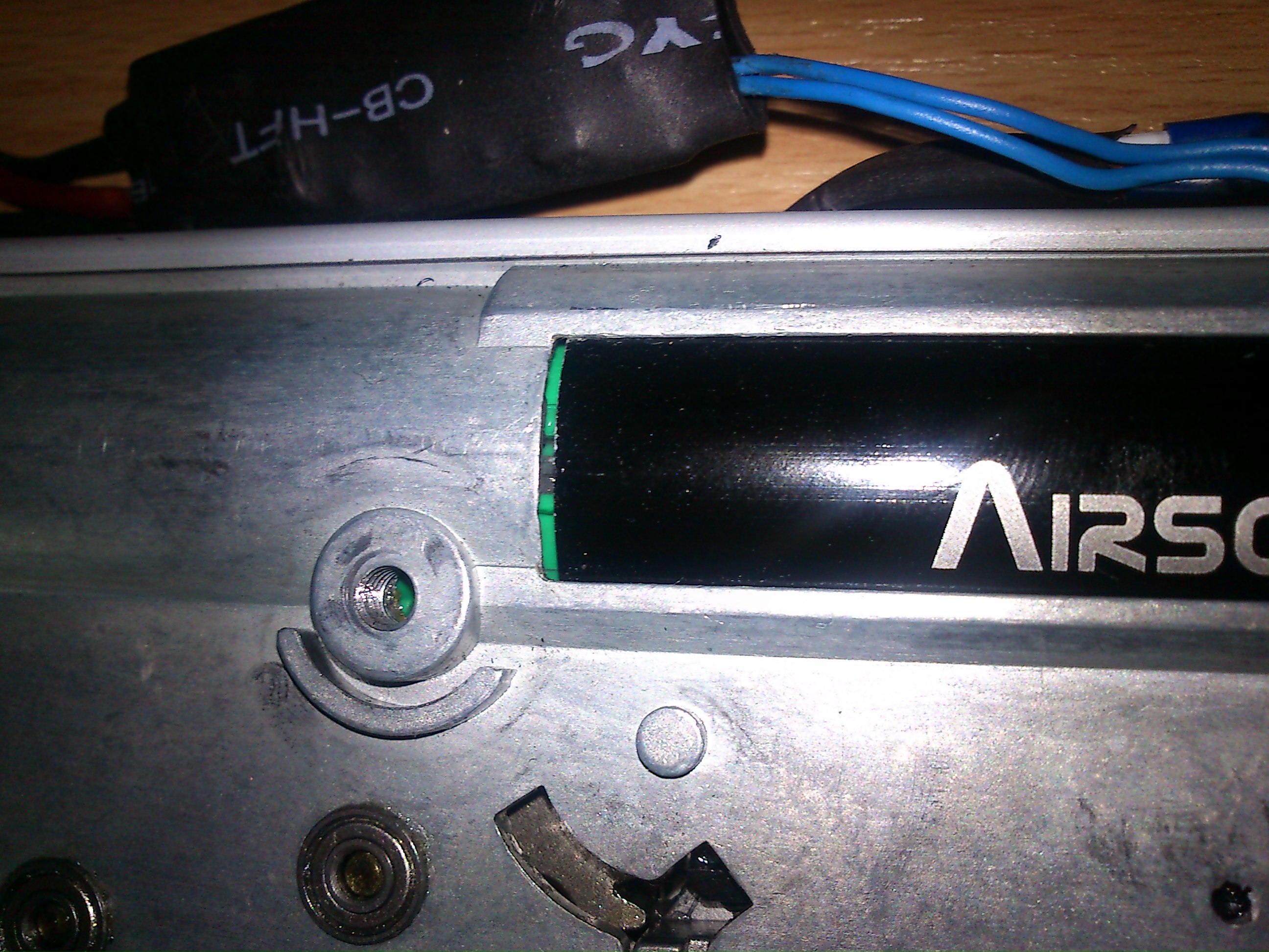

DSC_0003.JPG [ 725.1 KiB | Zobrazeno 8457 krát ]
Spravne je to slovensky digital les, ale spat k teme.
Daval niekto ine prevdody a piest ako znacka SRC do mech gen. III ?
Ako to sadlo?
DSC_0005.JPG [ 705.92 KiB | Zobrazeno 8457 krát ]
DSC_0002.JPG [ 803.7 KiB | Zobrazeno 8457 krát ]
Ak 74 D-boys RK-05 - sanded to steel, short barrel, AirsoftParts + AirsoftPro 130 spring + Pro Win Hop UP + Guarder black rubber + Jefftron Extreme processor unit - Basic + hight torque SRC motor
